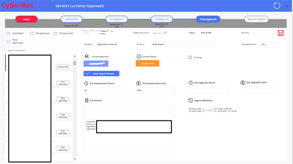

      I built an multi-level approval interface, patching the current approval status back to the record, when the approver selects one of the approval buttons on the top.
      for example:
      Set(varRecord, Patch(VCRequests, Gallery1.Selected,
          {Outcome: "PS Approved",
           PSApprovalDate: Today(),
           ApprovalHistory: DataCardValue42.Text & Char(13) & "PS Approved" & " - " & User().FullName & " - " & Now()
      Select(btnRefresh);
      VCPowerAppsApproval.Run(varRecord.ID, User().Email)
      the last step actually triggers a flow, but just for sending out a notification mail, based on current request settings.
