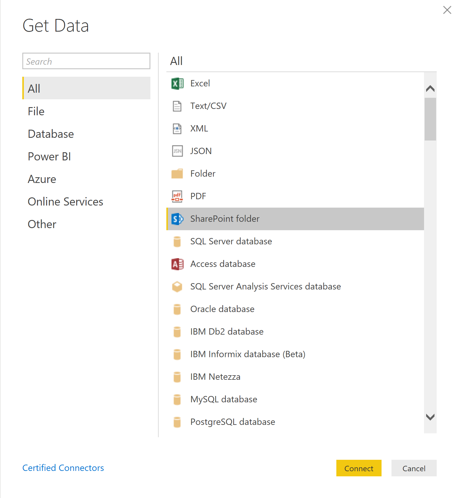

    • Mike Hammons
      August 1, 2019 at 3:29 PM
      Hi Holly,
      You can use the folder method I suggested with SharePoint as well….instead of choosing Folder, use SharePoint Folder and follow the same instructions after that. Note the URL needs to be the root of the site. What we like about the separate files is it reduces the accidental updating by end users of the wrong tab. Either approach is fine and accomplishes what you need.

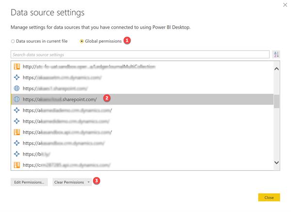

      I am not aware of any changes. I just used Get File>Web and then entered the URL for my Excel spreadsheet. Did you remove the last part of the URL?Ā https://tenant.sharepoint.com/sites/Team/Documents/Territory/Territory1.xlsx?web=1
      There might be cached credentials. Try and clear them and reconnect to your source.Ā
      Open Power BI, click Edit Queries, click Data Source Settings, this will show you a listing of all of your cached settings. Click the Global Permissions radio button, then scroll to your SharePoint/Web connection and click the Clear Permissions button, then click OK.
      PBI data source settings

    • Holly Kramer
      August 1, 2019 at 4:40 PM
      Hi Mike – yes I figured out it was the cached credentials, but it took me a bit to find how to clear them out.Ā  Thank you for the feedback.Ā  If I ever forget again, this will be easy to refer to again!
