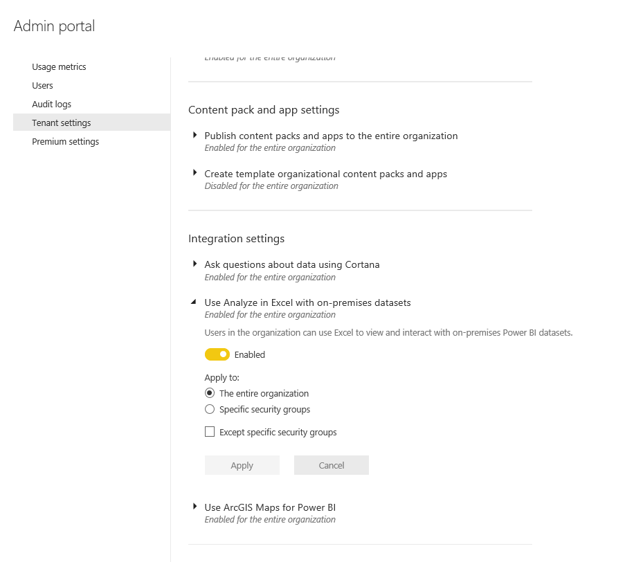

      I’ve recently discovered the “Analyze in Excel” feature that is seen when viewing reportsin online powerbi. It is seen when clicking on the 3 dots on the upper right hand portion of the screen. This concerns me because it gives my users a way to examine all of the underlying data from my database, which is much more than I’ve included in the report. Ā Is there a way to disable my users from having this feature. Ā I want to share a specific report with a colleague and have them only be able to interact with that specific report. I do not want them to be able to “Analyze in Excel” and see more of the data that they’re not intended to see.

      It looks like you can manage this at a global level in the Power BI admin settings. I found the proposed solution in the thread here:

      The admin portal can be used to limit the access the Analyze in Excel feature in the Power BI Service.
      Compared to the other thread it has (as so many other things in Power BI) been improved so you can specify groups etc.

      Thank you for the response! Ā I have one follow up question. Ā Is there a way to do this without a premium subscription? Ā Myself and my colleagues operate on pro memberships and do not have access to the admin portal.

      Isn’t Admin portal related more with Office 365 and it’s Admin than the type of Premium/Pro/Free account in Power BI? At least some time ago I saw in updates that Office 365 admin no longer has to be the same as Power BI. So if in your case these two were not separated, then I would guess O365 Admin should also be able to act as Power Bi admin.

      Since I didn’t have access, I was able to find an administrator within my organization that had access to the tenant settings, and was able to turn off the ‘Analyze in Excel’ tool. Ā Although he has turned off the tool, I’m still seeing this option in my shared reports. Ā I read one thread that claimed that I must also disable the ‘export data’ tool. Ā Is this true? Ā I would like to keep this tool since it only exports the data from visuals, and not the underlying data.Ā
      To summarize: I would like to disable the ‘Analyze in Excel’ tool, yet keep the ‘export data’ tool.

      Our Admin was able to turn off ‘Export Data’ along with ‘Analyze in Excel’ and now when I go through I no longer have access to either tool. I’ve seen in other threads that other people are having this problem as well, so hopefully Microsoft is currently working on it.

      I had our administrator disable both ‘Analyze in Excel’ and ‘Export data’ and this took away both options. Ā If you remember from before, we disabled ‘Analyze in Excel’ but this did not work, and we could still use this tool within the service. Ā Although we couldn’t find a way to keep ‘Export data’ without keeping ‘Analyze in Excel’, we found a better way to limit our users through RLS. Ā  Although our issue is solved, I am curious as to why both of these separate tools seem to be dependent upon each other, and welcome any insights as to what could be causing this.Ā

      From my understanding you have to have both options disabled to stop the Analyze in Excel.
      What I find interesting is that if you have to export the data from a visual this will export all the data supported by the underlying visual, which is just a piece of the entire dataset. Whilst using the Analyze in Excel does show the entire dataset that is published to the Power BI Service, it will not show any columns that are hidden.
      And in my opinion the visuals in the Power BI reports are representative of the underlying data, so even though the users might be able to see it in a pivot table, it is just a different format, but it is still the same underlying data.
