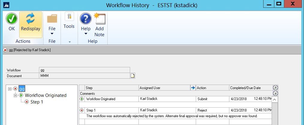

      Per Derek’s last response, if I mark “Action is always required for this step”, set the “Use alternate final approver” as me and I am also the only Manager assigned to this workflow, it still errors out.
      kls
      kls2
      I had my Network Administrator check our OU containers in Active Directory and we have all of the appropriate permissions.Ā  I have tested 2 different workflows and get the same result.
      Is there anything else we should check?
