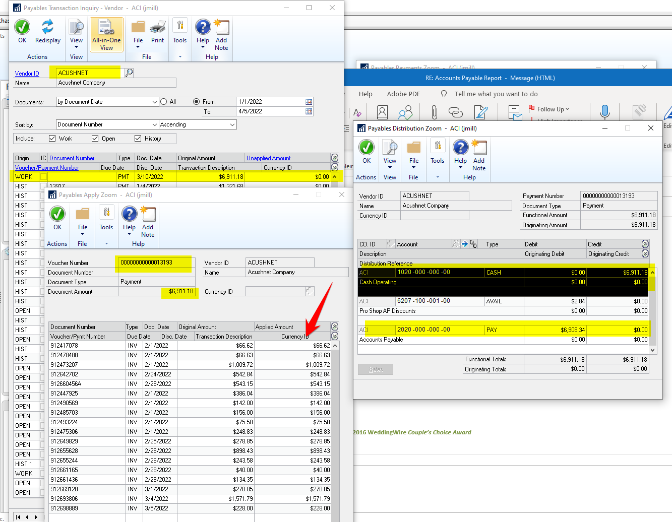

      We have a vendor who sent us a statement for past due AP invoices.Ā  They show as “paid” on out side.Ā  Looks like the culprit is this “work” transaction payment for $6911.18 – which looks like a payment but is not.Ā  Not sure what could have happened as we only cut checks on Tuesdays and this is a Thursday date.Ā  The “voucher” # 13193 is a valid check # from September 2021 for another vendor that was cleared and is no issue. I looked up online and it says it could be a posting interrupted but that again would seem strange as we don’t do payment on Thursday.Ā  Any ideas how we find out what happened and/or how we would fix?
      And is there a way to run a report for all “work” transaction – to make sure we don’t have any other issues out there?
      Any help would be appreciated!Ā  Joann

      Hi Joann,
      I would start with running a Payables reconcile for that Vendor.Ā  If that doesn’t fix it (I would guess it doesn’t), I would typically go into SQL to investigate the details of that voucher number.Ā  Depending on where it exists and doesn’t, it may mean a combination of SQL updates, deletes and/or Check Links to resolve the issue.Ā  If that is needed, I’d suggest to work with your partner that is familiar with these steps to assist.
