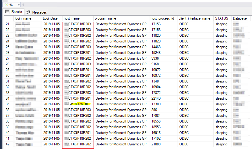

    • Beat Bucher
      November 5, 2019 at 10:57 AM
      Guys,
      I don’t know about you, but having to find out which IP Address belongs to which server is pretty bad.. I want the information at the tip of my fingers..Ā
      Don’t know if anything changed in GP 2018R2 and above, but this query below was tested against a Citrix Farm with 3 servers and 1 GP / SQL server.. And it returns every single user sessions from the GP ACTIVITY table with their corresponding server & DB name :Ā
      -- this query returns only GP clients with their host name to identify the actual session.
      SELECT DISTINCT(es.login_name)
      Ā Ā Ā Ā Ā Ā  ,Format(es.login_time,'yyyy-MM-dd', 'en-US') as LoginDate
      Ā Ā Ā Ā Ā Ā  ,es.host_name
      Ā Ā Ā Ā Ā Ā  ,es.program_name
      Ā Ā Ā Ā Ā Ā  ,es.host_process_id
      Ā Ā Ā Ā Ā Ā  ,es.client_interface_name
      Ā Ā Ā Ā Ā Ā  ,es.STATUS
      Ā Ā Ā Ā Ā Ā  --,es.database_id
      Ā Ā Ā Ā Ā Ā  --,sp.dbid
      Ā Ā Ā Ā Ā Ā  ,db_name(dbid) as 'Database'
      FROM sys.dm_exec_sessions AS es inner join sys.sysprocesses sp on es.session_id = sp.spid
      WHERE es.login_time > CONVERT(DATE, GETDATE() - 1)
      Ā Ā Ā Ā Ā Ā  AND es.login_name IN (
      Ā Ā Ā Ā Ā Ā Ā Ā Ā Ā Ā Ā Ā  SELECT USERID
      Ā Ā Ā Ā Ā Ā Ā Ā Ā Ā Ā Ā Ā  FROM DYNAMICS.dbo.ACTIVITY
      Ā Ā Ā Ā Ā Ā Ā Ā Ā Ā Ā Ā Ā  )
      Ā Ā Ā Ā Ā Ā  AND es.host_name <> ''
      Ā Ā Ā Ā Ā Ā  AND client_version = 7
      Ā Ā Ā Ā Ā Ā  AND es.program_name = 'Dexterity for Microsoft Dynamics GP'
      The output result could’t be clearer :
      As you can see, the one session running off the SQL server itself, while all the others are split between the various Citrix servers.
      This configuration is running off a Windows Server 2016, SQL server 2017 (14.0.17285) and GP 2018 R2.
      By using the Program Name field to filter out data for Dexterity only, I cut all the noise coming from MR 2012 sessions, or every other .NET application that is hooking up to the server.Ā
      Strangely enough, for some users, SQL is returning 2 different DB names under the same host_process_id, which I suspect might be a company change from within GP, without closing the session, in which case it just keeps the old DB ID in the session table, though it’s no longer using it. This is confirmed by using the full login_time stamp instead of truncating it to the single date only, showing that one company was used earlier by the same user.
      While not being perfect, it give a pretty good idea of who is logged on in GP thru which terminal / computer.
