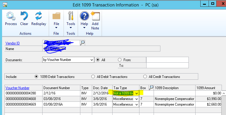

      I would start with Voiding the Historical Transaction and make sure to change the void date and the posting date to today. Ā Then when you reprint the check it would be today’s date and will wash itself out in the GL. Ā
      You can edit the 1099 transaction information and remove the transaction so it won’t show on this years 1099. Ā Go to Purchasing > Transactions > Edit 1099 Transaction Information. Ā In the tax type column select not a 1099 transaction. Ā That should do the trick.
      You may need security access for this window if you don’t normally do the 1099’s for the company.
