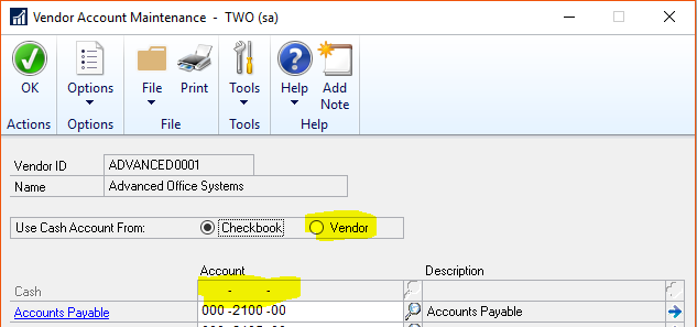

      November 16, 2017 at 3:27 PM
      That is weird.Ā  I would go check the vendor setup for that oneĀ  vendor.Ā  It’s possible that in the Vendor Acct Maint window somehow that vendor got checked to pull acct #Ā from vendor and the wrong cash acct is entered (or maybe defaulted from somewhere else like posting acct setup).
      Something to check. šŸ™‚

    • Thomas Hill
      November 17, 2017 at 9:19 AM
      Thanks for the suggestion Windi.Ā  I did check field and it is blank.Ā  If the whole batch had posted to the wrong GL, that would be “understandable”.Ā  But it was ONE check in a batch of 31.Ā  As I said, weird.
