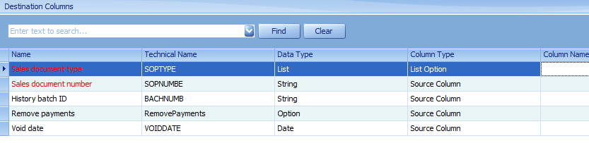

      If you are using SmartConnect, there is an eConnect node for voiding sales transactions:
      For the source query to feed the data into SmartConnect, you could just write a SQL statement to pick up all of the SOP invoices needed to be voided. Then in the mapping it just needs SOP Type and SOP Number:

      I did my testing – it seems like this node is only voiding the unposted SOP Invoice.Ā  What if the SOP Invoices are posted?
