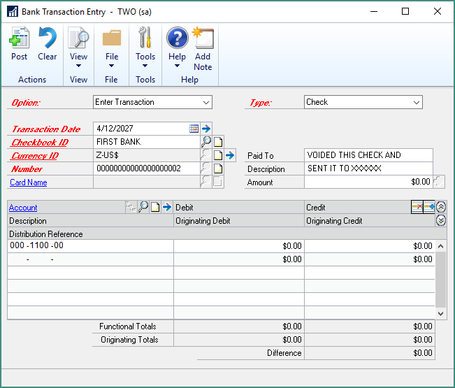

      December 13, 2018 at 3:51 PM
      If you have and are using Mekorma – then Shari’s suggestion is spot on – if you have pre-printed check-stock and are using GP out-of-the-box forms or non-Mekorma-printed-forms then you’ll record a check as voided or wasted this way:
      Go to Financial>Bank TransactionsĀ  enter a “Check”.Ā  You can even keep track of who you sent the check to in the description fields as in the pic below.Ā  Ā DO NOT enter anything down in distributions at all – just hit post and you’ve voided/wasted this check number
