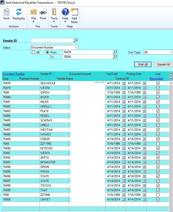

      A manual upload of vendors was done and checks were printed and posted for 154 transactions. Something happened in the system and the vendor names and the names printed on the checks don’t match. Is there a way to void all the checks and transactions as a batch instead of one-by-one?
      We will have to go in and do the upload again and create new vendors since the batch is incorrect. Is it best to put the incorrect ones on hold or make them inactive? I don’t think we want to delete them so that we have history in the system.

      You can void a range of checks at once.Ā  Go Purchasing-Transactions-Void Historical Transactions. Enter your first check to your last check that is in your batch that was incorrect.Ā

      Question – In order to void multiple checks at once, do they all have to be for the same vendor?Ā  Or can you void check #10000 through #10050 even though they are different vendors???

      Don’t enter a vendor id and yes you can void a range of checks as Tracy shows on the screenshot.?
