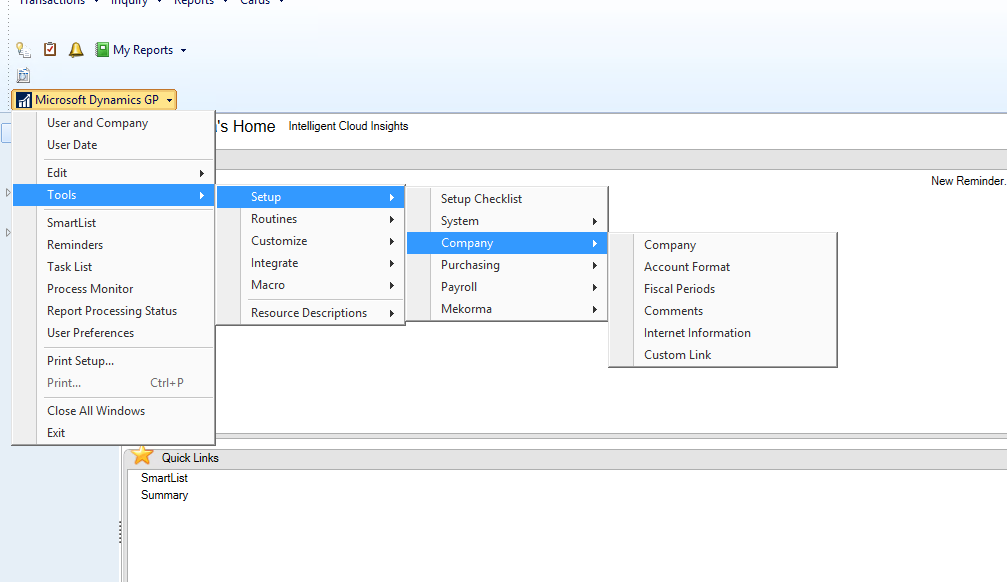

      Currently, when I go into tools to create a workflow, I do not have the required access the below screen is all I have, in our test environment I have the workflow maintenance option, how do we update but not in production, how can do we update this?

      By default, access to the Workflow Maintenance window is given to users via the ADMIN_COMPANY_013* security task.
      The ACCOUNTING MANAGER* security role, again by default, is the only role that assigns user the ADMIN_COMPANY_013* security task.
      POWERUSERS, of course, would have access to the Workflow Maintenance window as well.
      One other note, only POWERUSERS will see all of the workflow types in the Workflow Maintenance window, otherwise non-POWERUSERS that have access to this window will only see the window and nothing in it.
      The exception to this is those users whose Windows user account is specified as a Workflow Manager for a workflow type, in those cases, the user will see that specific workflow type, but that is it.
      For example, let’s say the Windows account of CONTOSOJOHNDOE is assigned as the workflow manager for the Purchase Order Approval workflow type but that is it, and his GP login is not a POWERUSER, but has access to the Workflow Maintenance window. When this user logs into GP, as long as he’s also logged onto the machine as CONTOSOJOHNDOE, in the Workflow Maintenance window, he’ll see the PO Approval workflow available to him to add/remove/modify as needed, but won’t see any other workflow types.
      If this user was not logged on as CONTOSOJOHNDOE, but still the same GP login that has access to Workflow Maintenance, he would be able to access the window, but not access any workflow types.
