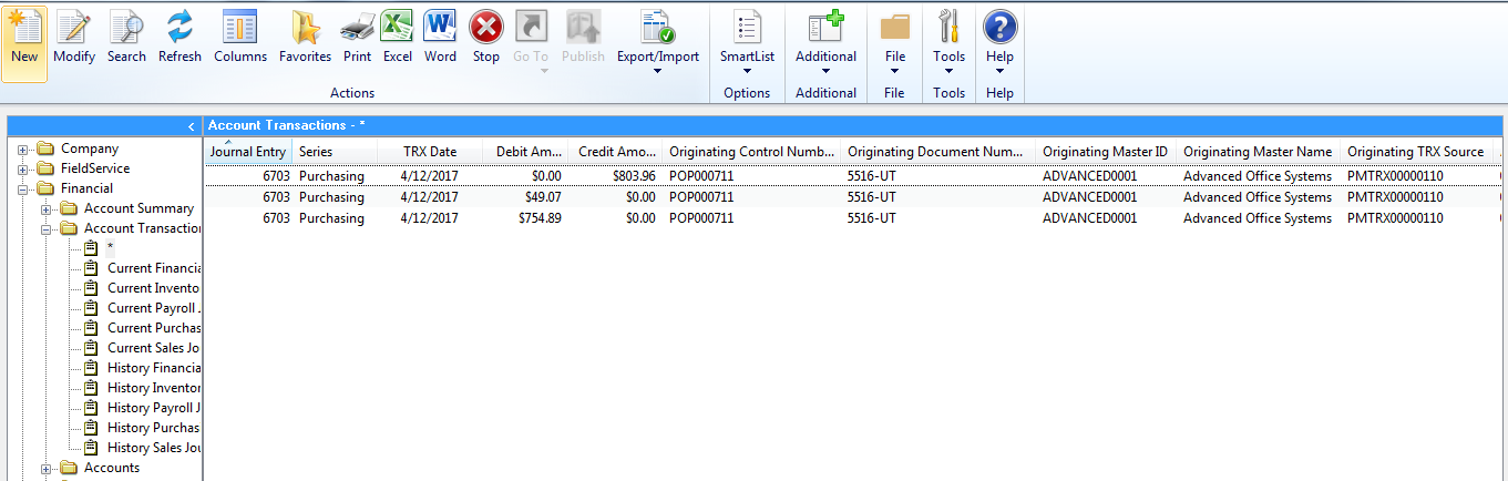

    • Thaddeus Suter
      September 8, 2017 at 9:21 AM
      Yanna, When the Journal Entries are unposted in the GL but originated from AP, you cannot directly see the source in the unposted Journal Entry without a small customization with GP Modifier.
      However the good news is if you use Smartlist you can find everything you need to know before posting the GL Batch.
      Use Smartist – Financial – Account Transcations and set your search to the Journal Entry Number(s) in the unposted batch.
      Then expose the Originating Control, Doc and Master ID w Name columns you see in the screenshot below.
      That will give you all the info to go to Inquiry in AP on the vendor and find the posted AP Trx in payables management.

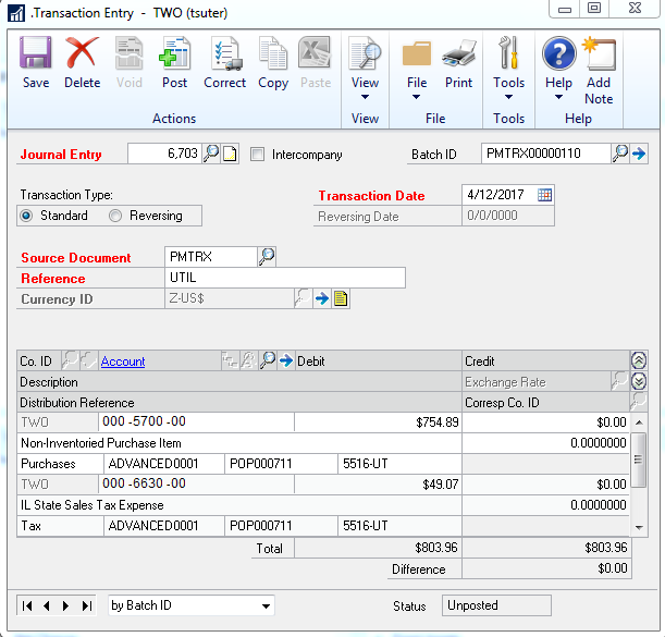

    • Thaddeus Suter
      September 8, 2017 at 9:47 AM
      Yanna,
      Here is the standard customization in place so you can see the PMTRX suource vendor and data in the unposted GJ Ā in GL before you post.
      This is a very common mod that your VAR can give you as now you don’t need to use Smartlist to chase down the subsidiary ledger values for unposted GJs.
      See the Description Reference line of the expanded Ā GL Entry below.
      The GJ is same as up Ā above and originated in PMTRX and was Posted To the GL but not Thru the GL.
