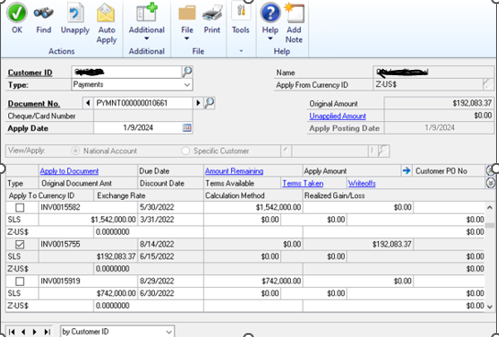

    Hi there,
    one of our users is having an issue applying an invoice.
    The invoice is there and shows for $192,083.37, when he clicks the box for that invoice it shows the “unapplied” amount go to 0.00
    but when he clicks the OK button, it changes the “unapplied amount” to
    $4,090.00. I’ve already ran file maintenance last night (Check Links/Reconcile) but the issue persists.
    This is something I have never come across before and looking for assistance if possible.
    TIA
    Monya

    So without seeing the backend SQL, the couple of things that come to mind are…
    1. Is there any payments in WORK that may have applied to this invoice also?
    2. Did you check for STUCK Batches?
    3. Do you use Multi-Currency? Functional / Operational
    Otherwise you need to check the Applied Payments Table…
    SELECT * FROM RM20201 WHERE APTODCNM = ‘INV0015755’
    SELECT * FROM RM30201 WHERE APTODCNM = ‘INV0015755’
    These will tell you if anything has been applied to these documents from another ‘broken’ process.
