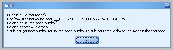

      I’m using a SmartConnect journal entry (financial) map per GP company and one map is throwing a strange error:
      SmartConnect Error
      The map was originally created using the Duplicate Map option, then changing the Company to import to.
      I am also using a GP Rolling column for the Journal Entry Number, so I changed the company that the GP Rolling column is pointing to as well.
      I also tried creating the map the old-fashioned way – from scratch – same result.
      The GP company is only used for quarterly/year-end entries and I can manually create journal entries without issue.
      We’re on SC version 20.16.1.24, with GP 2016 R2.
      Thanks in advance!

      Check if this stored procedureĀ [E1_SC_GetNextNumber] is in the Company that you were integrating to.Ā  If not, just copy it from another company that has it and run it to the company.

      You were correct – all of the “E1_SC_” stored procs were missing in this relatively new GP company – I scripted them out, added a GRANT statement and ran it against each of our company databases. Many of our newer databases didn’t have these SPs.
      Worked like a charm – Thanks!
