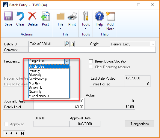

      It’s super simple – you’ll just save your transaction into a recurring batch.Ā
      You can create a batch in Financial>Transaction>Batches
      Give it a memorable ID, make sure it’s a General Entry (you can use the other types if you know how to use them), the Select the frequency you want it to reoccur in.Ā Ā  If you choose monthly the date of the transaction will increment up by one month each time you post it.Ā  If you choose weekly the transaction will increment up by 7 days, etc.Ā  If you select Misc you can choose how many days to increment it up by.
      The only caveat is that these will not auto-post with GP out-of-the-box you’ll need to remind yourself to go in and post them.
