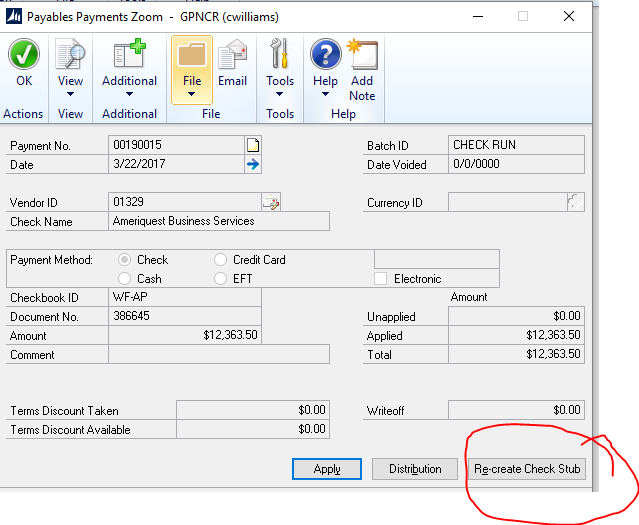

      Does anyone know the Task that would enable a User to Re-create Check Stub? Thanks

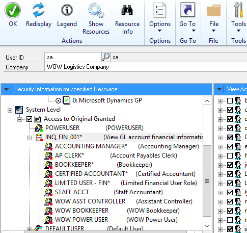

      Looks like INQ_FIN_001*. Here’s a screenshot of GP Power Tools:

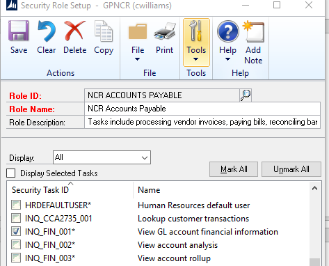

      The Role already has INQ_FIN_001* checked. Any help would be appreciated!

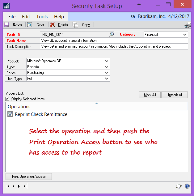

      I agree with Sparkly Steve. The Reprint Check Remittance was included in the INQ_FIN_001* task. It may have been changed by someone in your organization, but on my installation, that report exists only in the INQ_FIN_001* task. You can check yours out by opening the task and looking at what’s included. Mine is in the graphic posted to this message.
