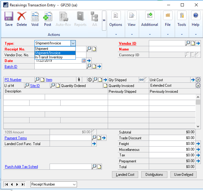

      In GP, there are some ‘Document Access’ security operations.
      Ex.) Purchase Order Window, ‘Document Access’ options for Standard, Drop-Ship, Blanket, Drop-Ship Blanket.
      Assuming I’m not just overlooking options for the receivings transaction types (Shipment, Shipment/Invoice, In-Transit Inventory), what are some other options to grant a person access to the receivings transaction entry window but ultimately prevent them from being able to enter shipment/invoices?
      Can’t use Field-Level security because it’s a required field…

      You are registered for GP Power Tools including the Developer Tools module. This can be easily written as a quick trigger and assigned to the users you want to lock down, or to all users.
      Let me know if you need assistance.

      There may be a couple of options including a Field Level Security option.Ā
      The options in this post seem reasonable, but I haven’t tried them yet.
      https://community.dynamics.com/gp/f/32/t/155836Ā

      Both options were suitable and will do the trick!
