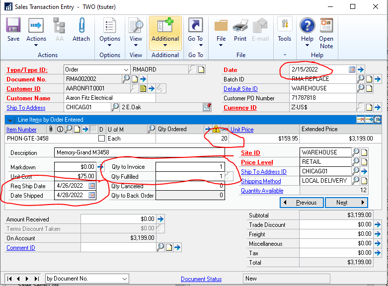

      April 29, 2022 at 9:28 AM
      Its is done like this:
      One master order with Qty 20 is taken. You then Invoice and Fulfill one at a time until the 20 is gone.
      The Freight is added to the Invoice after you pick/pack ship the Qty One.
