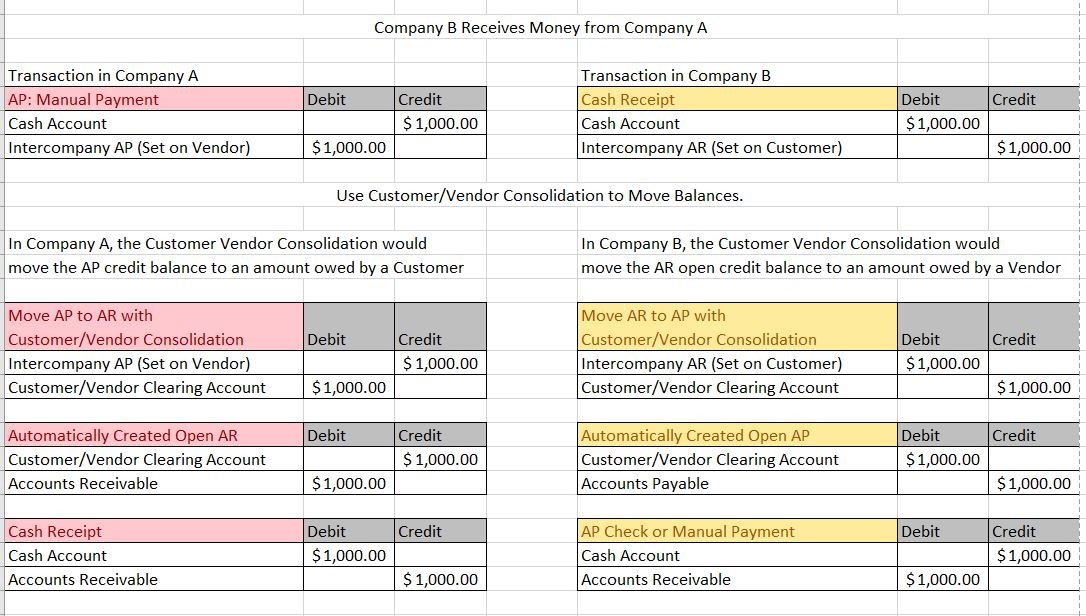

      I had an idea to use the Customer/Vendor Consolidation functionality to move these balances. You could setup a customer and Vendor for each Company in the main company (Company A) and then setup Company A as a Customer and a vendor in each of the LLC’s that are getting funding.
      I figured out the distributions (see attached for an Excel Version)
      Let me know what you think. I wrote up a Tech Tip on setting up Customer Vendor Consolidations. You would just be using it for these specific Vendors and Customers.

      I wanted to add an idea I emailed directly to Tammy. She said the volume of the transactions was too big to rely on using the Customer/Vendor Consolidations. She had an integration built that could apply open AR and open AP so I refer to that below. If you were going to implement this, you would need to apply the documents manually or build an integration too:
      If you can apply with the map you built…you would just import all the transactions the Customer/Vendor consolidation automates (with the same GL accounts)
      1. Import Manual Payment into Origin Company: Vendor = LLC’s (I would setup the LLC’s with a special AP account. That way you can track the open AP separately. Also, I would put them in a class like “ZZZ-INTERCOMPANY”) so that they can be excluded from Aging Reports (if you have other vendors in classes…it would work).
      2. Import Cash Receipt in Destination Company: Customer = Origin Company (I would setup a Customer with a Vendor ID/Class ID “ZZZ-CORPORATE”. I would also use a special AR account (set as default on the customer).
      1. Each LLC needs this customer.
      2. Keeping AR in a separate account will help you balance the AR to the GL later.
    • When everything is paid (Transactions in Origin Company):
      1. Import AP Transaction (I’d pick Misc Charge so that I could exclude if someone wants “Total AP invoices for the year”)
      2. Apply AP Manual Payment to the new AP Misc Charge
      3. In same company: Import AR Debit Memo
      4. In same company: Create Cash Receipt (this is the real payback from the LLC’s). Post and do Bank Deposit to update the GL and Checkbook.
    • When LLC pays corporate (Transactions in Destination Company)
      1. Import AR Debit memo (This is to zero out balance in AR special account).
      2. Apply Cash Receipt to new Debit Memo
      3. Import AP Misc Charge (to Create open AP)
      4. Pay Corporate back manually with a check or with other payment method using Manual Payment window.
      As I was writing that…I thought of another option:
      1. Import AP Transaction (I’d pick Misc Charge so that I could exclude if someone wants “Total AP invoices for the year”) USE A DUE TO/DUE FROM ACCOUNT
      1. Import AR Debit memo (This is to zero out balance in AR special account). USE A DUE TO/DUE FROM ACCOUNT
      Skip the last step to move from AP to AR….after you import the Misc Charge and Debit Memo, you will have cleared AP and AR (yay!!) just do your Bank Transactions import at that step (in both companies) and use the offset USE  DUE TO/DUE FROM used for the Debit Memo and Misc Charge!
