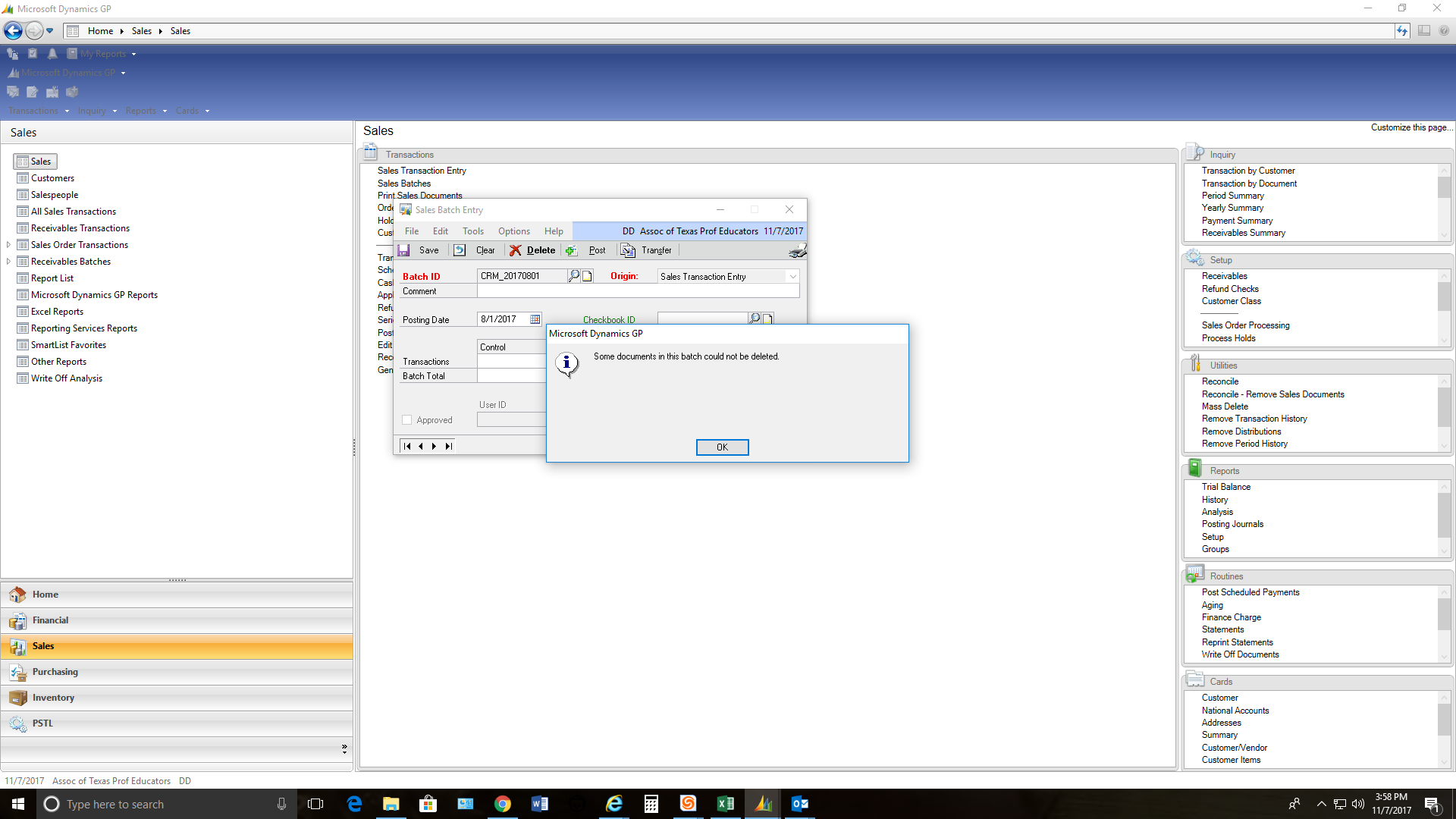

      I have a sales batch that I am trying to delete and I get this message when I try to delete.Ā  I have not ever had this problem before and I am not sure what to do.
      sales batch delete

    • Steve Burney
      November 7, 2017 at 5:22 PM
      ?Hello Debbie,
      Is there a chance that this batch has been approved for posting?
      If so, that is one reason why the system will not let you delete it.
      Just an idea to check.

    • Windi Epperson
      November 7, 2017 at 6:16 PM
      Debbie,
      If any of the invoices in the batch have been printed, then they can’t be deleted.Ā  You will have to void those invoices.Ā

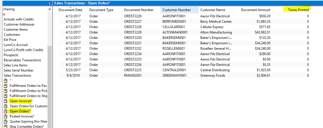

    • Windi Epperson
      November 8, 2017 at 10:28 AM
      Like Bruce said, in SmartList choose Sales Transactions then Open Orders (or Invoices) and add the Times Printed field.
      If only some have been printed, you can pull those transactions up and move them to another batch, then delete the batch.Ā  If all have been printed, you’ll have to void each transaction.
