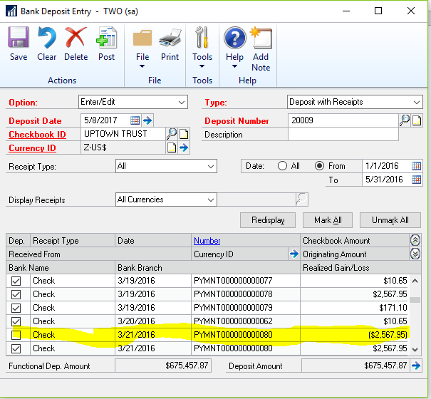

      A few clarifications. IĀ didĀ reconcile the check in my May Bank Reconciliation module, as the bank originally marked it ‘cleared.’ (This occurred at the end of May). The check must have gone through some sort of audit process wherein the bank determined it could not indeed be deposited and returned the check in June. In doing so, they debited our account for the amount of the check.Ā
      So, as I always do in these instances, I voided the cash receipt via the Sales Posted Transactions window. I used the June dates as my void date and entry date. Generally after I do this, the negative deposit appears in the deposit screen but this is not the case. Because of this, it is also not appearing on my bank reconciliation module, so that I can now account for the debit to our bank account in early June.Ā

      Not sure why the voided check did not show up in the receipts list. But to get around this you can create a deposit without receipts in the instance to get the deposit onto the bank reconciliation. If I remember right you stated that the g/l is correct.
      In the future instead of voiding the cash receipt I would use the NSF functionality. If you do not want an NSF amount setup you can change it to zero. If I recall correctly this will create the bank reconciliation entry at the same time and you would not need to do a bank deposit on the transaction.

      have you found a solution for this issue? I run into exactly the same situation . Ā  Normally after using the NFS function for the check, the amount Ā (negative value) Ā would show in the Bank Deposits screen . Ā Currently Ā the Amount showing in the Deposit screen is $0 instead of the negativeĀ $ amount.
      Steps :
      1. Check from your customer recorded and applied Ā to the invoice.Ā
      2. Deposited the check to your checking account (Deposit with receipt)
      3. NFS CheckĀ
      NormallyĀ after this step the negative deposit appears in the deposit screen but this is no longer working the amount showing in the deposit screen is $0.
