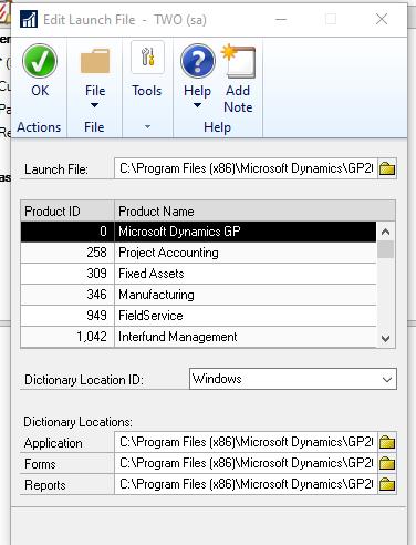

      3.) When you are logged into GP, can you navigate to Microsoft Dynamics GP>>Tools>>Setup>>System>>Edit Launch file.Ā  Ā A pop up window should appear.Ā  If you click on the product name Microsoft Dynamics GP, it should tell you where the system is looking for the forms and reports dictionaries at based on how your SET file is configured.Ā  If so, can you confirm that the dictionary files actually live (and are accessible to users) in the file path shown in that screenshot?
