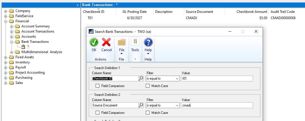

    • Gerald Buenafe
      November 4, 2019 at 5:56 PM
      Hi Sharie,
      While in the Report Option window, when clicking on the lookup button for the Audit Trail code, a list will be provided – which includes the person who processed it as well as the date… you can use those as basis…
      Another option would be to make use of the Bank Transaction SmartList… add the Audit Trail code column and then make a restriction on the checkbook and the source document prefix (CMADJ)…
      Gerald Buenafe
      Owner/Consultant
      BTP Technologies LLC
      CHANTILLY VA
    • Jackie Hodge
      November 4, 2019 at 6:31 PM
      ,Ā Ā Ā  ??’s detail above should be helpful.Ā  Also, if you open the looking glass it’s usually the last CMADJ that you created you are looking for.Ā
