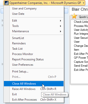

      In addition to using the Process Monitor, many people don’t know about the “Close all Windows” function in Dynamics GP.Ā  It can be very helpful in closing everything before trying to exit from Dynamics GP – especially since many people have a half dozen windows open at any given time.
      Close All Windows
      Note – I’ve seen this window quite frequently when the user prints a report which takes a few minutes to load and display.Ā  This can be anything from simply printing an invoice to running a Smartlist.Ā  I’ve had to advise my users to be patient.Ā  They do have to close the report before attempting to exit Dynamics GP to avoid this message.
