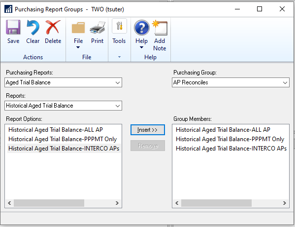

    • Thaddeus Suter
      May 13, 2022 at 11:49 AM
      You don’t want them manual. You are able to create the AP and PPMT reconciling subledger reports in GP with GP Report Writer. That is one of the benefits of using the PPPMT. Also by exposing the PPPMT Transaction sources in Smartlist you can make a Favorite for reconciling just the Prepayments Asset Account. That Smartlist report is real time in GP and not date sensitive.
      If you need it to be date sensitive (and most people do) then it is done in the GP Report WriterĀ  tool using one of your AP Trail Balance Options. Again you expose the Transaction Source PPPMT doc numbers and the most elegant method is to use Conditionals and Restrictions in Report Writer to create a modified AP TB Report that on one side removes PPMTs from the report and on the other side returns only PPMTs in the report.
      That way you have can both reconciling reports as GP run reports. Exclude Fully Paid Documents is typically always marked so you canĀ  key of that for True AP and IntercoAPĀ  and if Unmarked then PPPMT.
      The other thing you can do for reconciling is simply use aĀ  data Sort option and thus have a single report but you must include all GL Accounts that carry AP and PPPMT. Most GLs have more than one AP Account anyway as I like to separate Intercompany APs in the GL for easier elimination so typically there are 6-8 AP accounts or more ( for sister companies) Ā that in total will tie to the AP Trail Balance account (if it is run as a single report). In those cases, I run the AP Trial Balance by Vendor Class for Interco vendor and create a Report Group ofmultiple Report Options.
      You can always make these AP Trial Balance report “Excel ready” by eliminating headers, page breaks, skip lines and so on and have them auto print to a file
      However method you choose, once you make the Options and modify in Report Writer with restrictions, sorts or conditionals, then you create the Group so they can run together.
