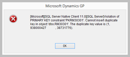

      Kindly help me to resolve a Paid Transaction Removal error. I get the violation of Primary Key constraint ‘PKRM30301’ error as below.Ā Ā
      Paid Transaction Removal window;
      Error:

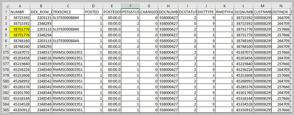

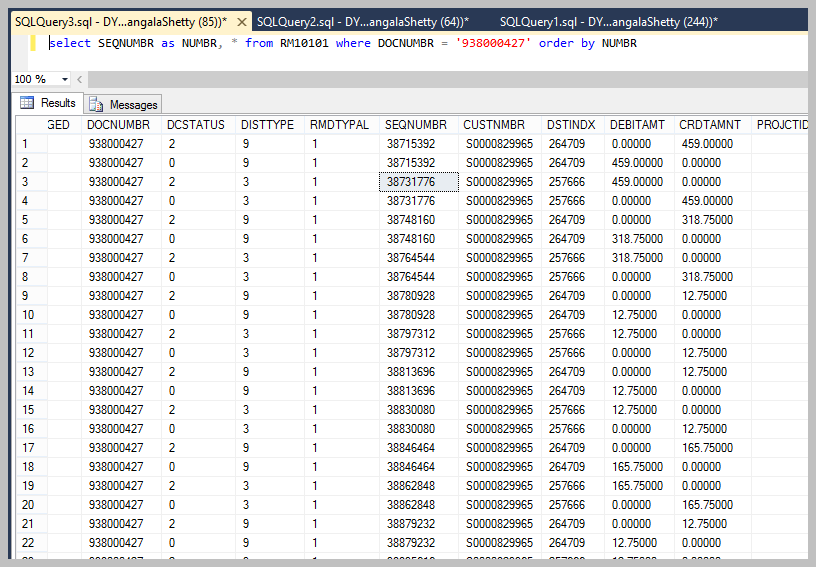

      I ran the below query and I see that there are 3 documents with the same SEQNUMBR in the table RM10101.
      All the sequence numbers above looks correctly incremented by 16384.

      Your scripts seem to be pulling from the RM10101, but the error message indicates table RM30301.Ā  I would recommend checking that table and seeing how things shake out.

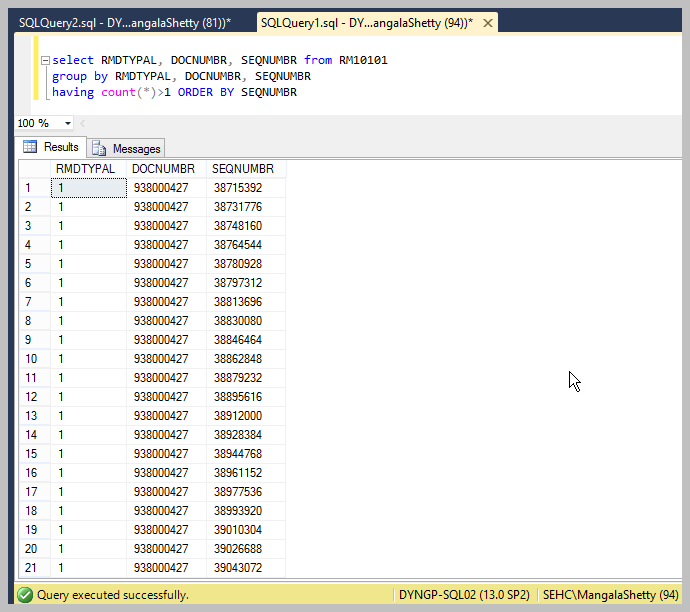

      I have the below results. Kindly help.Ā
      Mariano’s query did not generate any results.
      I have the duplicate document numbers as the document is voided. The other sequence numbers appear twice, but the error is caused only by seq# 38731776.
      Should I update the sequence number under RM10101 ?

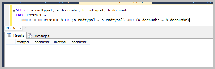

      is right, the issue is not just in the RM10101, but the RM30301, likely it is due to a duplicate Document Number between the two.
      See if you can find it this way:
      –RM Duplicates
      select RMDTYPAL, DOCNUMBR, COUNT(*) as [COUNT] from
      select RMDTYPAL, RMDNUMWK as DOCNUMBR from RM10301 W
      UNION ALL
      select RMDTYPAL, DOCNUMBR from RM10201 W
      UNION ALL
      select RMDTYPAL, DOCNUMBR from RM20101 O
      UNION ALL
      select RMDTYPAL, DOCNUMBR from RM30101 H
      ) C
      group by RMDTYPAL, DOCNUMBR
      having COUNT(*) > 1

    • Mangala S
      July 28, 2021 at 6:30 PM
      Thank you Jo,
      I ran the query but with no results.

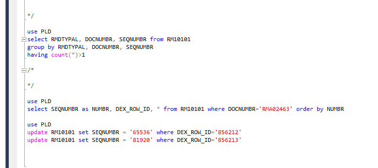

      I get this error a few times a year when an RMA is applied to multiple invoices.Ā  I use the method in the Microsoft article to update RM10101.Ā  Here’s one I saved:

      Thank you Ken,
      Can I update the SEQ number to 45367296 ( 45350912+16384) and 45383680Ā  as the last seq number for this document number in RM10101 is 45350912?

    • Ken Roy
      July 29, 2021 at 9:19 PM
      Mangala,
      I can not speak on your data as that’s for you to decide.Ā  I can say that is the increment GP uses and I used to fix the problem as the article stated.Ā

    • Mangala S
      July 29, 2021 at 11:37 PM
      Thanks Ken!
      My worry is I have multiple records that appear twice on different lines, but I get error only on this document. That’s why I am confused.
      I will backup DB and try this approach and will update here. Thank you very much for all the responses.
