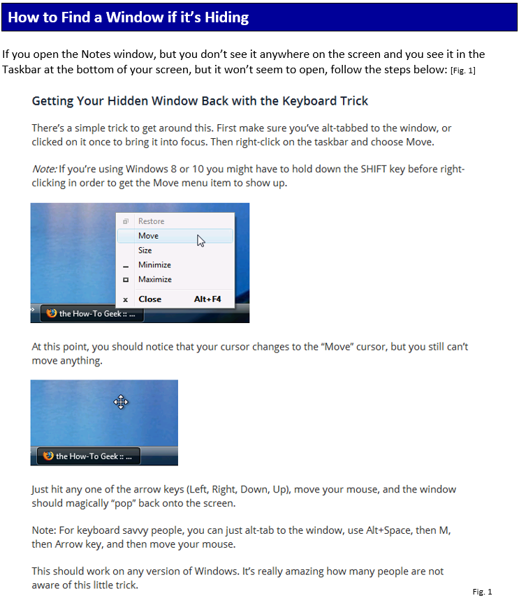

    • Frank Heslin
      December 20, 2016 at 11:51 AM
      Robert,
      I like to “Teach” my users to help themselves:-)
      I’ve sent this out to many of my users:  (Found on ‘The How-To Geek’)
