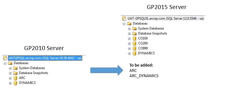

      m1wHFFVR8iOPaaf9qjog_Named_DYNAMICS.JPG?Once GP2010 DYNAMICS andĀ ARC dbĀ is upgraded to GP2015, can I copy/restore DYNAMICS db into named ARC_DYNAMICS under GP2015 new server where DYNAMICS db already exist?

      HiĀ Cecile,
      The short answer is yes and as you might imagine, there’s a but. Ā Not only do you have to setup your new GP instance with the new system database name but you have to run a few SQL scripts as well. Ā I did this same process when we upgraded to GP 2016 and it worked quite well.
      I didn’t write the scripts and my apologies to the author(s) as I don’t remember where I found them but they are available online somewhere.
      I had to rename the attached files to include the “.txt” file extension because the GPUG site wouldn’t allow “.sql” as the file extension. Ā
      Anyway, edit and execute theĀ GPCompanyUpdateDBNAME.sql SQL script on all company databases that will be attached to this system database. Ā Edit and execute theĀ GPSY00100Update.sqlĀ script on all company databases that will be attached to this system database, replace DYNSL with your new system database name. Ā Edit and execute the GPSystemDBUpdate.sql script on the new system database, replace DYNMC with your new system database name.
      Once all of this is done you will likely need to follow the security procedures that are part of the move GP to a new server instruction set. Ā Let me know if you need any more help with this procedure.

    • Cecile Dinh
      June 20, 2017 at 10:17 AM
      I
    • Tom Monfre
      June 20, 2017 at 12:33 PM
      HiĀ Cecile,
      The screens you’re showing are GP Utilities and that’s not where the decision is made. Ā The setting for a custom system database name is on the sixth page of the installation wizard. Ā You would go to theĀ MDGP2016_R2_DVD_ENUS or installation folder of the version you want and launch setup.exe. Ā On the first page click Microsoft Dynamics GP under the Install heading and install as required. Ā When you get to the sixth page, enter the system database name you want to use in the Enter Custom Name filed and proceed as normal.
