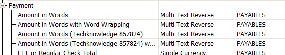

      PS: as for the Mekorma Check Configurator, you may open a support call with them to validate what those options means.. since it looks like there are 4 different types of ‘Amount in Words’ available :
