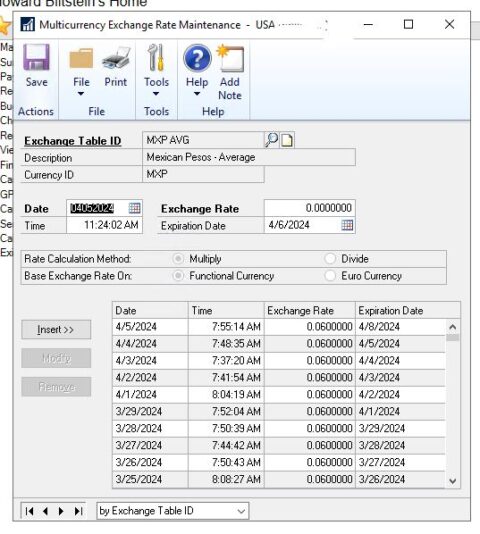

    To get past the posting errors, which still do not say anything about rate being expired, I did an update to the MC00100 table and pushed out Expiration dates a year for the rate that correspond to the invoice dates from the PM10000 table. That allowed all the batches to get posted.

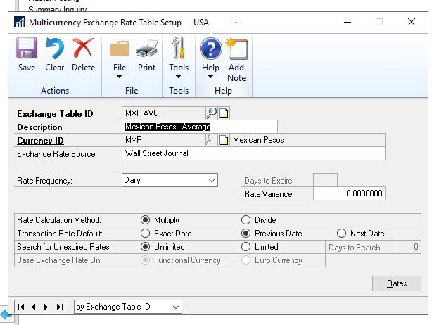

    Our user that manually maintains the rates, updates it every day. Should we adjust how the daily rates are entered? Should the expiration date be entered using a date way in the future? Attached are pics of the table setup and the rate window. Are we doing something wrong?

      GP is smart, in that it will use the NEWEST exchange Rate that fits the date range.
      (Time is also a consideration)
      Example:
      Transaction Date = 2024-04-03 it will use 1.37000
      EXCHANGE TABLE
      DATE TIME RATE EXPIRY DATE
      2024-04-04 12:00.00 AM 1.38000 2024-05-01
      2024-04-03 12:00.00 AM 1.37000 2024-05-01
      2024-04-02 12:00.00 AM 1.36000 2024-05-01
      2024-04-01 12:00.00 AM 1.35000 2024-05-01
      So if you do Daily and it is NOT an automated process (Manually Entered) I suggest you at least set the expiry date 1 week, incase the person responsible is away.
      I would also highly suggest you set the times always to 12:00.00 AM – this makes sure you are doing true days.

    The exchange rate differences you are noting between the payment coming out of the bank and the GP equivalent are due to the dates you have in your exchange rate table setup in GP administration tab.
    It sounds like you have a bit of a mess on your hands, and it appears that you are missing key setup pieces.
    For instance the blog you mentioned advised you can pay those vendors through a separate checkbook – you can actually assign those vendors to that checkbook and better control the currency. You assign that on the options tab of the vendor card.
