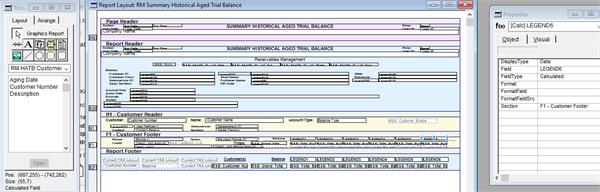

      The additional aging buckets are not appearing on the generated report. I have verified that the correct “modified” report is enabled, double checked the info in report writer and verified that there is data for those buckets.Ā

      Please don’t shoot me for saying this I know obvious, but make sure you are looking at the correct version of the report.Ā  Also, what else is common is to make sure the user you are logged in as has the alternate/modified forms and reports ID that you gave access to this modified report.
      I will sometimes put the word TEST at the top of a report in a bright color to make sure it is really seeing the modified version.
      Let me know if you need any assistance.

      It is hard to see the details in your RW screen shot, but here are some points to check:
      * Make sure you are using the Current TRX Amount array field
      * Display Type should be set to Sum
      * Visibility is set to Visible
      Please see complete steps here:
      https://support.microsoft.com/en-us/help/857284/how-to-add-aging-buckets-to-the-rm-summary-historical-aged-trial-balan
