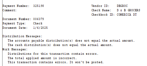

    The Payables Batch IDs still shows the Batch IDs for each payment as available, but now we’re seeing a message that says the check number was already used and there’s nothing to post it to. I did see errors on each of these batches, distribution messages and work messages attached. User stated it was because she tried multiple times and now it says the document number has already been used.

    I would try deleting — but only in a test company… also record the voucher numbers because you might need to run a script to look for any remaining entries for these payments in the tables and manually remove them after.. :-/

    Made some researches with Dynamics consulting team https://www.hiredynamicsdevelopers.com/dynamics-365-consulting-services/. This can happen when things get interrupted, leaving entries stuck in Work status. That can mess up your invoices. The error message you see, like ā€œYou can’t choose this document because it is part of a recovered batch or is still in the process of posting,ā€ means that GP sees the batch as partly done but couldn’t finish it.
    First, check the batch status. If it’s stuck in Work, see if the payments were partially posted. You can try clearing the batch. Go to Payables Batches and delete any unposted transactions. Or, use the Batch Recovery process found under Tools > Routines > Recovery. This should help reset the status.
    If the check number is marked as already used, it’s probably from that earlier posting issue. You can fix this by clearing the unposted payments and deleting the batches in Payables Transaction (go to Tools > Utilities > Delete Payables Transaction). Once that’s done, run Check Links and Reconcile to keep your data correct. After you clear the batch, re-enter the payments in the Manual Payment Entry window. Make sure to link them to the right invoices. When you post the batch again, it should go through fine.
