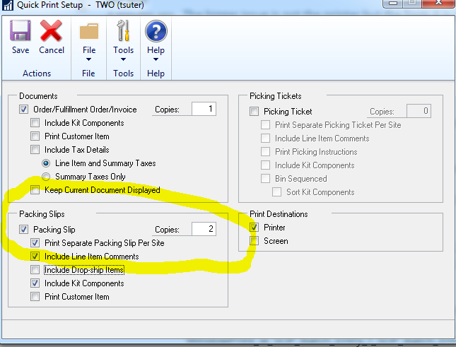

      For two copies of the pack slip to print maybe use this:

      Where would i find the Quick Print setup (I’m using GP2015 R2)?

    • Tim Andaya
      March 1, 2018 at 2:02 PM
      Hi Jeff,
      Sales Transaction Entry –> Options –> Quick Print Setup

    • Thaddeus Suter
      March 1, 2018 at 7:13 PM
      For order/transaction printing use Quick Print Setups.
      For Batch Printing use Named printers.
