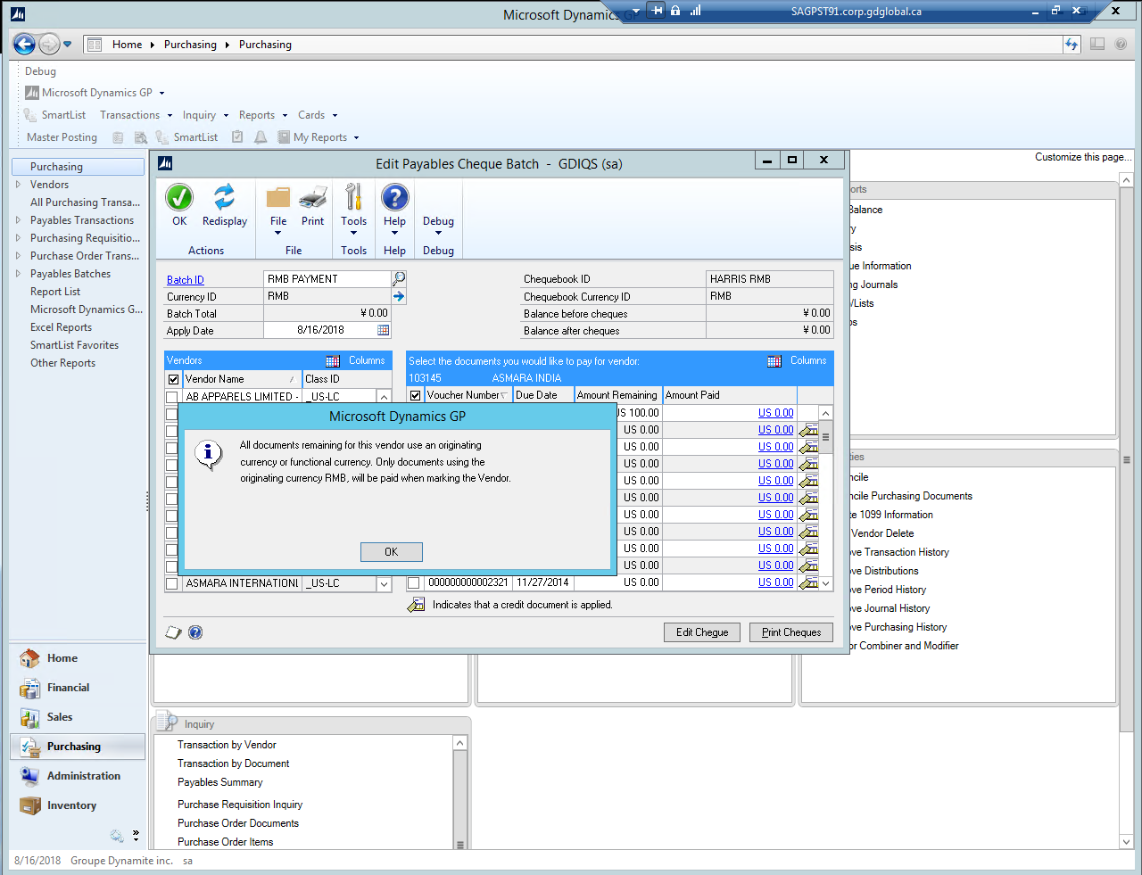

      Thanks for your response,Ā  we do use Multicurrency Module.Ā  Our company has a the canadian dollar as functional currency and we have not problem with our US vendors paying in USD.Ā  However the new situation we have is the suppliers invoice us in USD as usual but if we pay in another currency we could receive a discount. So ideally we would like GP to allow us to enter the transaction entry in USD but pay in other currency, which it does not seem to allow.
      In the transaction entry window we set the currency to USD,Ā  but when we try to create a batch for payment using other currency RMB it does not allow us to select any US dollar transactions.Ā  This is the error we received.Ā  I have a check book for this currency I want to paywith and have a FX table.
      Ā Ā Payable error
      I was surprised GP had this limitation and wondering if I am doing something wrong or if it something GP just won’t allow.Ā  Also wondering if there are any third party products.

      I can’t speak into third parties that may be able to do this, but with native GP functions I can’t see how the system can pay an invoice in a currency that is not the same as the checkbook that the payment will be made from.
      In our companies that use something other than USD for their functional currency, if they receive a USD invoice they enter it in USD,Ā and then make the payment from their USD checkbook. If they receive an invoice that is in a currency other than those they are able to make payments in, they either convert it to one of the currencies they can use, or they go through the broker who sends foreign currencies that we do not transact in through GP.
      For the example that you gave, do you operate a RMB checkbook account? If so you can convert the invoice per the rate of the date of input, enter a RMB invoice that can then be paid through your RMB account. Your vendor who issued the USD invoice will not be affected by this, they will receive the currency they requested, the rest is GP paperwork.

      GP Multicurrency is not two dimensional it is only one dimensional so that functionality does not exist.
      GP works like this:
      Functional Currency = Z-C$
      Originating Currency = Z-US$
      Originating Currency = Z-RMB$
      There are only two rate tables in GP for this. Ie., one dimensional rate exchange between the Functional Currency and each Originating Currencies.
      To do what you want would require aĀ  cross rate between originating Currencies. Ie. Z-US$ and Z-RMB$Ā  Ā but GP has no rate table for this or the logic for a two dimensional rate table with the cross rates between originating currencies.
      Here is a sample.
      Functional Currency Z-C$
      Vendor X has three invoices in different originating currencies:
      Ā  1. Z-US$ 1000 – originating
      Ā  2. Z-C$Ā  $1300 – functional
      Ā  3. Z-RMB$Ā  – originating
      I can pay them in any currency, but I can only pay two of the invoices in any one originating currency or all three in Functional C$ currency.
      Why, because there is no cross match rate table for US$ to RMB$ (originating to originating).
      So if I am paying in US$ the RMB$ will not be allowed, only the C$
      And ifĀ  am paying in RMB$ the US$ will not be allowed, only the C$
      And lastly if I am paying in CN$ all three can be selected.
