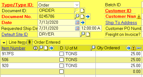

      Nope! Renumbering the line items into one continuous range of numbers and making that the sole “key” field in the Integration did nothing to maintain the order of the line items in GP. Here’s the way some of the Orders come out:
      The order in the Excel file (which is what I want) is 506, 920, 917FS.
      Any ideas?

    • Valerie Sikora
      July 13, 2020 at 9:29 AM
      Hi Steve,Ā
      Have you triedĀ setting the “UseOptimizedFiltering=False” in the Microsoft.Dynamics.GP.IntegrationManager.ini file?Ā  That worked for me once.

    • Steve Erbach
      July 13, 2020 at 11:31 AM
      YES!??! Oh, my goodness! That did it! All of that banging my head against the wall was starting to leave a mark! Thank you.
