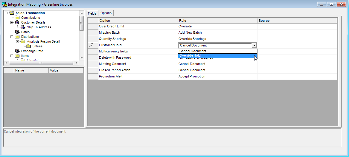

    • Blair Christensen
      February 6, 2019 at 11:58 AM
      Overriding Customer Holds in Integration Manager?I misunderstood which one you were using.Ā  Apologies.
      If you look at the options for the Receivables integration, there is an option to override Holds (see image).Ā  You might try that.

    • Thomas Hill
      February 6, 2019 at 12:16 PM
      Thanks Blair.Ā  I will check that configuration option.Ā  I am still wrapping my hands around Integration Manager.Ā  I am about to tackle integrating the checks that have cleared into Banking.
