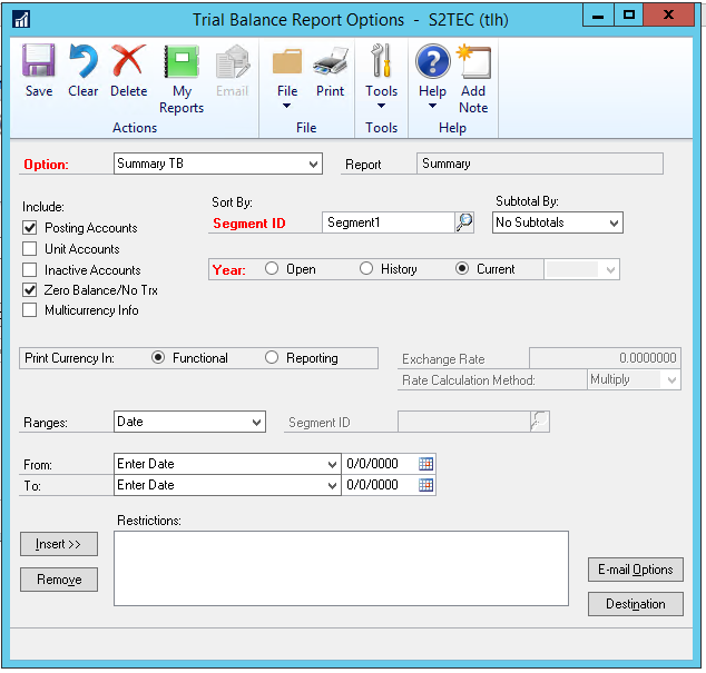

      You could also print a Trial Balance and mark the box to Include Zero Balance/No TrxĀ accounts.
