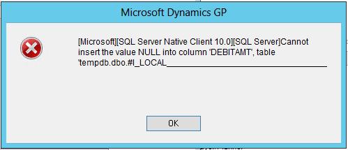

      When trying the run the HITB report we are getting this error:
      error hitb
      At one point I had found a single item that I could run and get it to throw the error, but the second time I ran it I didn’t get the error.
      Any ideas?

      July 13, 2020 at 11:26 AM
      Hi Andy,
      Are you still having this error message?Ā  What report are you trying to run?

    • Kevin Droz
      July 14, 2020 at 5:06 PM
      Take a look atĀ SEE30303 in SQL for possible corruption or missing data in column referenced in the error, do you know if you ran it last month?
      Also could a temp table issue related to SQL and you may need to restart your SQL DB.
