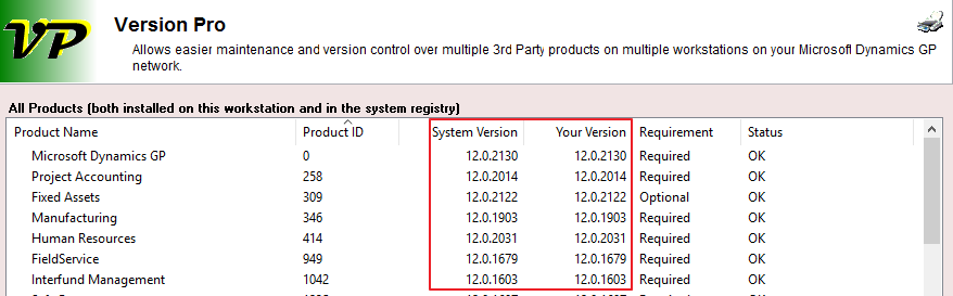

      If you don’t have a nice tool like Rockton’s Toolbox “Version Pro Products” report, which shows you every individual module & 3rd party installed in Ā GP, you’ll need to dig into the DYNAMICS..DU000020 table to find out.Ā  The main GP dictionnary has the ID ‘0’.
      Version Pro Products list the installed version on a particular GP client and compares it with what’s registered in the system.. this way you can quickly spot (and alert by e-mail) any client discrepancies vs. the server and prevent a user to login to GP..
      The DU000020 table will show you the same information, just not nicely formated, though you can always create your own Excel report and just keep the essential data.
