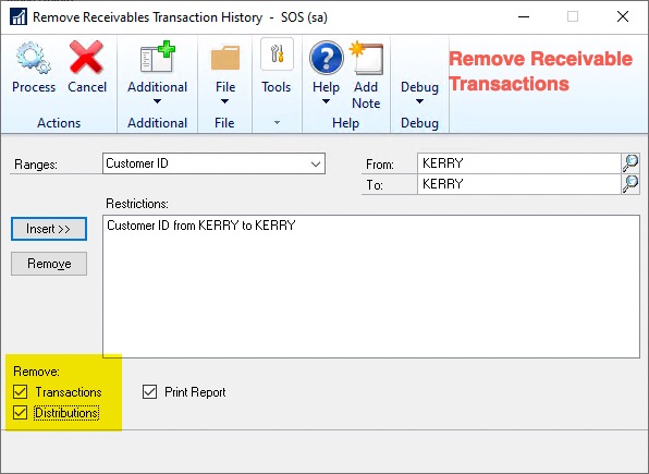

    1. Remove Historical Transactions (Receivable – Non SOP Sales)
    1. Sales >> Utilities >> Remove Transaction History
    1. Range = Select ONLY the Customer you want to DELETE
    2. Verify that ‘Transactions’ and ‘Distributions’ are selected (Bottom left corner)

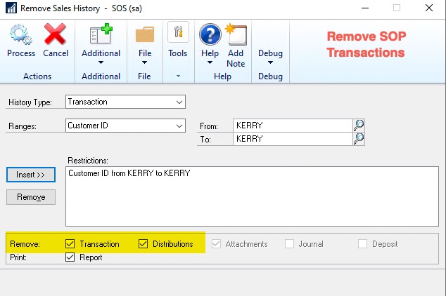

  • Remove Sales History (SOP Sales)
    1. Sales >> Utilities >> Remove Sales History
    1. History Type = Transaction
    2. Range = Select ONLY the Customer you want to DELETE
    3. Remove both ‘Transaction’ and ‘Distribution’
