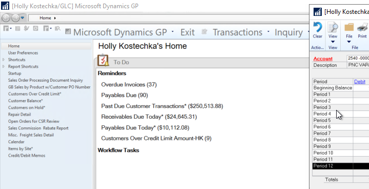

      This isn’t a solution, unfortunately; more of a shared misery statement. We’re transitioning from fat client GP installations to a Remote Desktop Server? installation. Until all the add-ons work properly, we’re giving the users the choice to run locally or remotely.
      One user, and only one user (out of 7), sees “normal” sized GP fonts with her local copy of GP running. When she switches to remote she gets a hodge-podge of font sizes:
      Her menu bar uses LARGE fonts; the “To Do” list and the transaction windows all have “normal” font sizes; and the navigation list has teeny font size.
      We use the font size adjustment utility in ‘sĀ GP Power Tools. Everybody else using Remote GP has no trouble. Just this one user.
