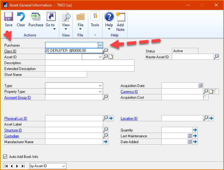

      ?”I added 3 assets in February all through the entry method of entering an invoice posting to 1601-999-999-99 F/A Clearing and set up each asset as a new number. “
      When you ‘added’ them, did you use the Purchasing Table dropdown to add them or did you just hand-key in a new asset?
      This addition using the Purchasing Drop down is what clears out the FA Clearing Account.

      I did use the drop down.Ā  I figured out that’s why my second went to Disposals because then I voided it to re-enter and start over.Ā  But for my last one I can’t see where it went wrong.Ā  It is in the fixed asset list correctly, and is depreciating correctly.Ā  So how could it have gotten into Fixed Assets without zeroing out my F/A Clearing account?
