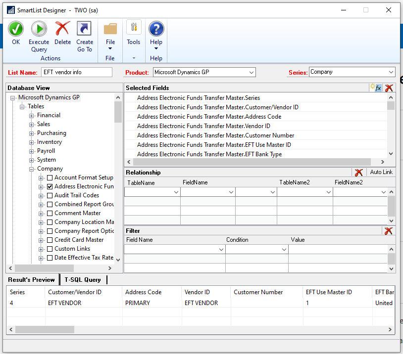

    • Gerald Buenafe
      November 5, 2019 at 6:12 PM
      Hi Lenny,
      The data in the Vendor EFT Bank Maintenance window resides in SY0600 / Address Electronic Funds Transfer Master
      A custom SmartList can be made using SmartList Designer / Builder to pull up the data.

    • Gerald Buenafe
      November 6, 2019 at 10:46 AM
      Lenny,
      yes you should be able to export to excel.Ā  You are already using smartlist at this point, so in Smartlist there is an excel button in the toolbar, just click that and it should export the data to excel.

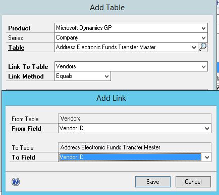

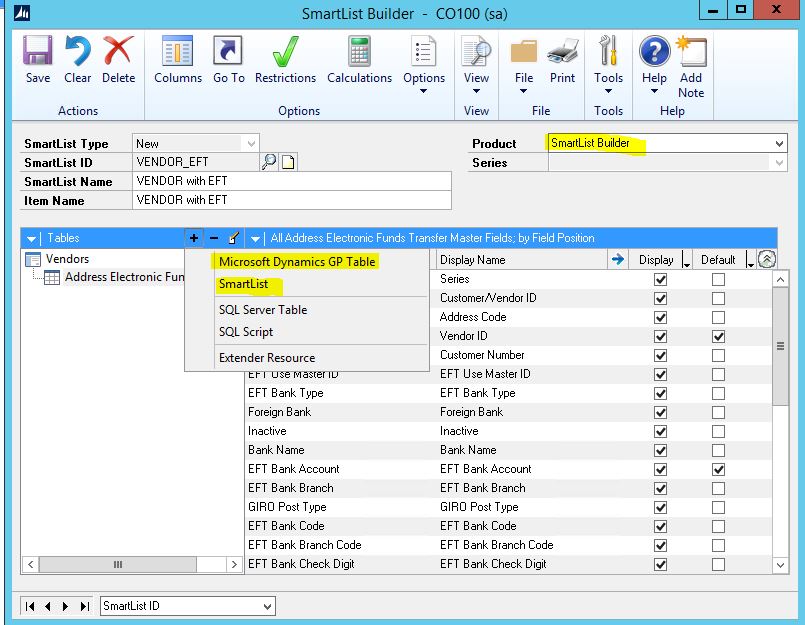

    • Cecile Dinh
      November 5, 2019 at 6:30 PM
      Hi Lenny,
      In addition to Gerald’s Smartlist designer… here is the screenshot from Smartlist Builder:
      Step 1 – add Smartlist >> Vendor
      Step 2 – add Dynamics GP Table >>Ā Address Electronic Funds Transfer
      Step 3 –Ā  add link
      Step 4 – Save under Smartlist Builder Product so you know which ones are added/modified.
