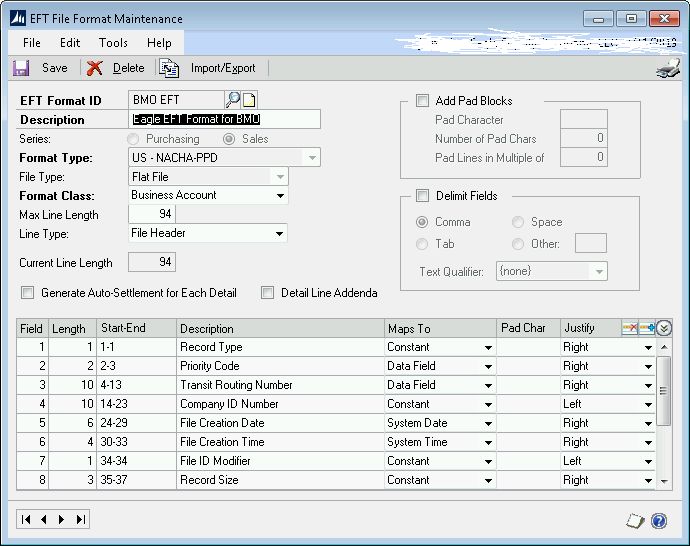

      Looking at the error message it seems to indicate that you are missing the EFT file format setup for that checkbook.Ā  When you go to the EFT File Format do you see a file format for the checkbook?Ā  It would be this window.

      Simply go to your chequebook (checkbook!) > EFT Bank > Payables Options and check to see if the File Format is listed there. Perhaps with the power outage, something was messed up in setup (although that would indicate you might have other issues too).
      The error indicates the checkbook doesn’t have a format selected for it to use.
      is correct, if the format is missing entirely, you may need to recreate it. At that point, my recommendation would be to restore a backup of your company from prior to the power outage to a test company database so that you can export the format and import to the company to easily recreate it and know it’s exact.
