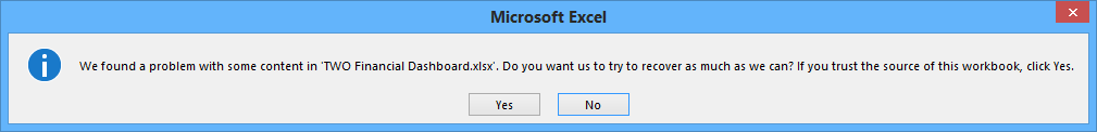

      “We found a problem with some content in ‘TWO Financial Dashboard.xlsx’. Do you want us to try to recover as much as we can? If you trust the source of this workbook, click Yes.”
      Clicking “No” gets you nowhere since Excel won’t open the workbook. Clicking “Yes” sets Excel to working on repairing the workbook. After a moment it opens with this message:

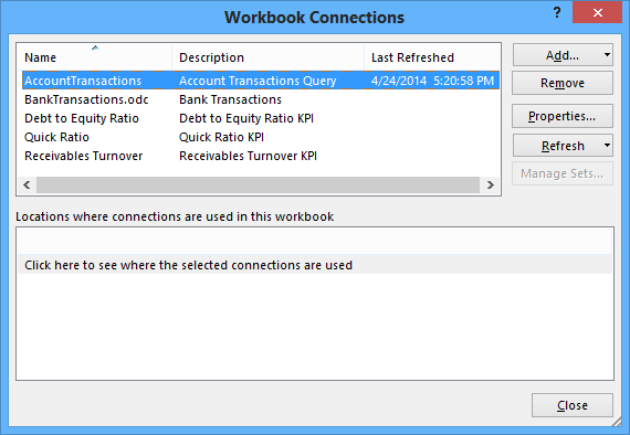

      OK, so the workbook is opened. There are five Data Connections:

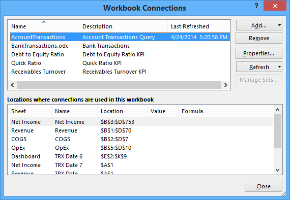

      Clicking to “see where the selected connections are used” gives me this for the AccountTransactions connection:

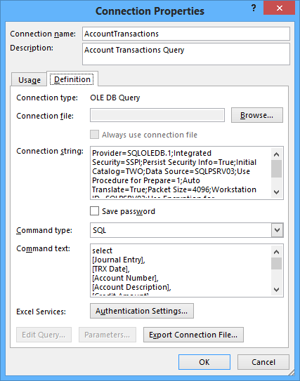

      When I click on “Properties…” I see the Connection Properties dialog box (last refreshed in April 2014); so I click on the “Definition” tab to get this:
      Since I’m looking at the TWO version of the Financial dashboard, I can see that the “Initial Catalog” in the “Connection string” points to the proper database on the proper server, SQLPSRV03 in our case.
      But it’s the “Command text:” that’s screwy:

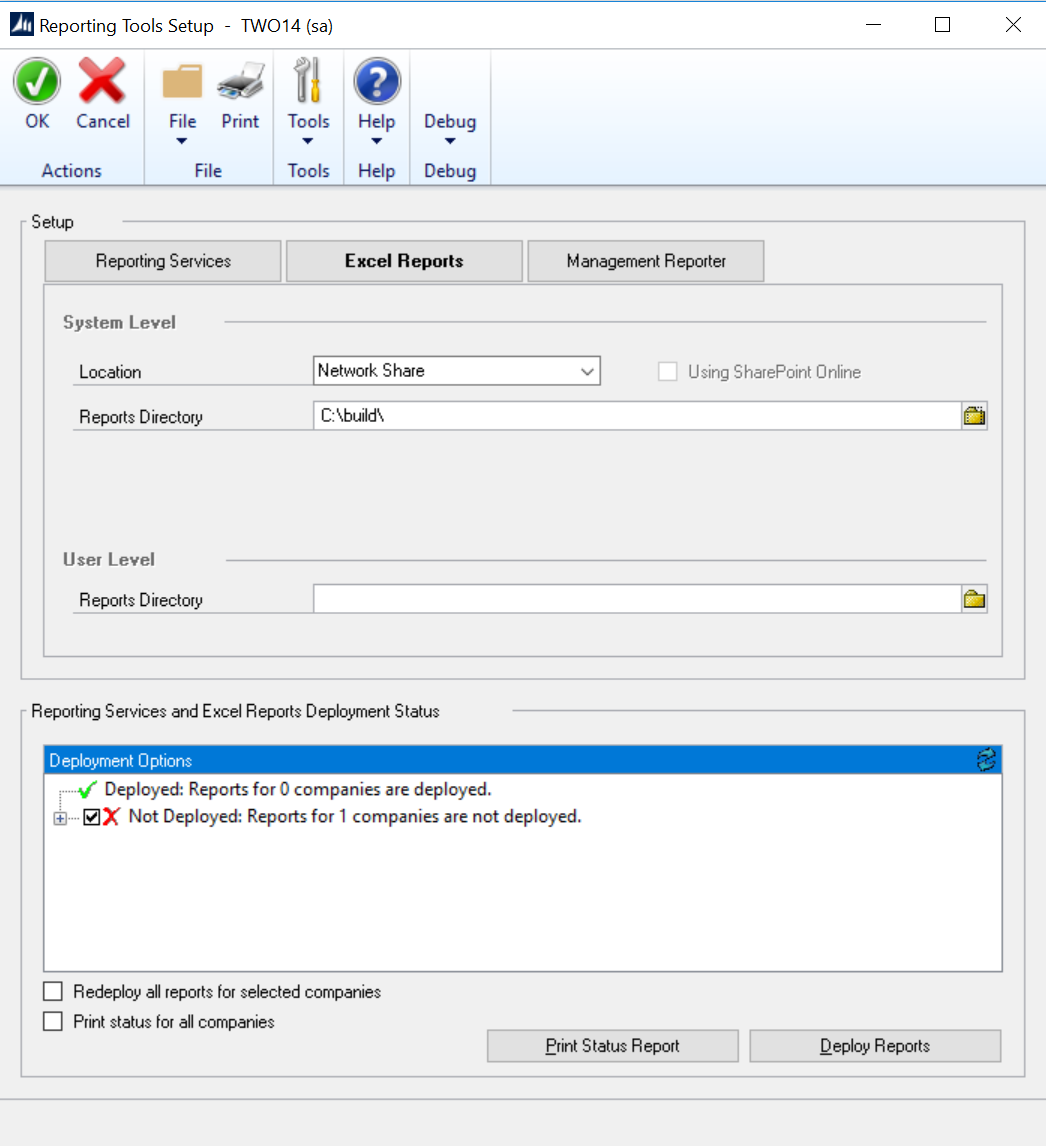

      Here is some information about Excel Reports that you might be able to use when configuring the dashboards.
      These are intended to be fully functional out of the box and connected to your live company database via the Reporting Tools Setup window. These examples are provided for customers to build their own rendition of dashboards for the following modules. Financial, Sales, Purchasing and Inventory.
      We don’t recommend deploying reports for the sample company and then changing all the data connections to be directed to your live company.
      The deployment takes care of that part of the configuration. You will want to deploy locally for your live company and make changes to that report, then copy it to the network location after changing it to best fit your needs. Remember to save as a different Excel document and keep the original in a safe location.

      July 22, 2019 at 5:00 PM
      If you are using the Out of the Box Excel Refreshables and have not altered the TEST Financial Dashboard, then you should go to the Excel Refreshables that deployed for your Live Company Database.Ā
      If you did not deploy them use the steps above to deploy them for Live.
      Otherwise,
      In Excel go to Data>Queries and Connections, double click on one of the connections or hit Edit on it.?
      Go to the “Definition” tab and change “Catalog=TEST” to Catalog=”your live GP database ID
      This is assuming that the TEST db and the Live company are on the same SQL Server.
