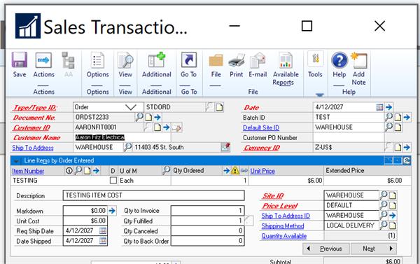

      Since there is no history at all, I would second ?? and recommend checking to see if the “Display Item Unit Cost” is checked.Ā  Attached are two screenshots of the exact same sales order which contains a brand new item I just set up with a current cost (I’m using perpetual valuation) but no history.Ā Ā
      The first screenshot shows how the order is viewed when the “Display Item Unit Cost” is checked.Ā  The second shows how the order is viewed when the “Display Item Unit Cost” is unchecked.

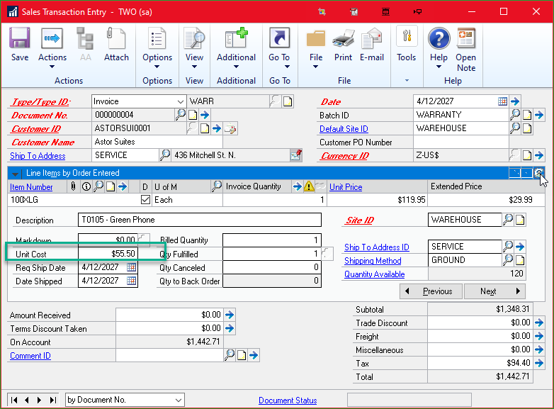

      If you go to Sales>Setup>Sales Order Processing there is an option to display the cost during data entry (caveat, you can see it, but can’t change it in SOP).
      Here is what the setup looks like:
      Here is how it displays in SOP Entry
