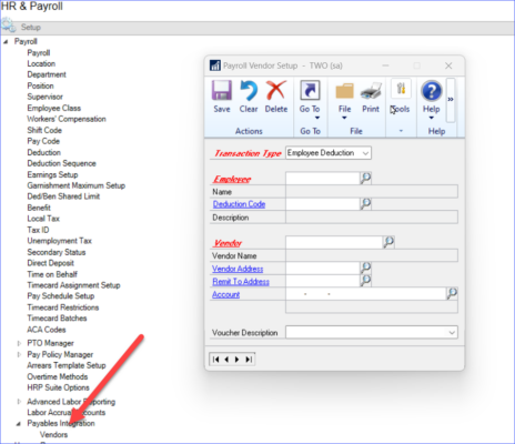

    Hi @pamelastephenson
    When you say tax update, was that the year-end update?
    Either way, it’s also possible someone messed with existing configurations.
    Please check your Vendor setup window in payroll along with checking the settings on that particular garnishment.

    It wasn’t the year-end update, we did that in December, and it worked fine after that. It was just the payroll tax update, that updates the federal and state tax tables for 2024 levels.
    I checked what you show, and the settings there look the same as other employee child support settings.
    Not sure what messed it up.
