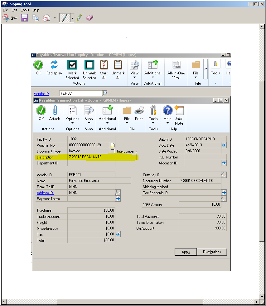

       One of the issues is that, we do not know how to add memos to our checks(This is not our check just a sample),
      please see screen shots below.
      See second screenshot below:  The highlighted field in yellow is the data that I would like
      to appear on the check like the memo on this sample check.  Can anyone, please assist?

      If you print your checks individually from the Payables Transaction entry window, you can put the description in the memo field. If you print them from a check batch created in any other way, you cannot. How would you handle the descriptions if a single check paid off multiple invoices? What would go on the memo line in that case?

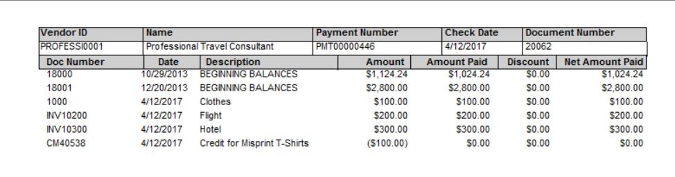

      I was able to add it to the Check Stub. Contact me directly (or have your partner contact me) for the details. I had to create a conditional Calculated field and change security. Because it is more involved, it would be best to talk about it. It also looks like you are using Binary Stream Multi-Entity Management. I know many of the GP reports are modified because of this product. I am not sure about the Check Format. I can create the description field, but I don’t know if there are any special considerations because of that product….I wouldn’t think so…but I am not sure.
      Feel free to email me.
      Here is what I was able to do (Added Description Column below):
