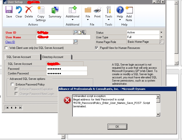

      We cannot reset passwords in GP and we keep getting this error message. We’ve tried to reset passwords in the SQL server and it does not work. We think its because Dynamics GP encrypts passwords differently then in SQL. If anyone can help we could appreciate it.Ā

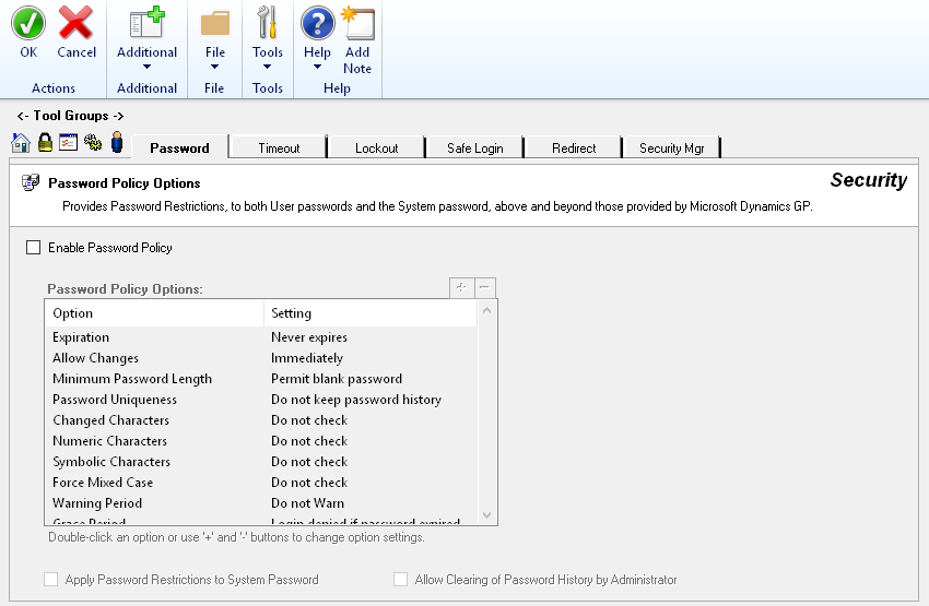

      The Error tells me you have Rockton Software ToolBox installed…
      So you need to start there and see what you have setup.
      To get moving you can simply ‘UNCHECK’ the ‘Enable Password Policy’ from Rockton to adjust.

      We made sure that setting is unchecked; should we reinstall GP without any add-ons and then try to reset password?
